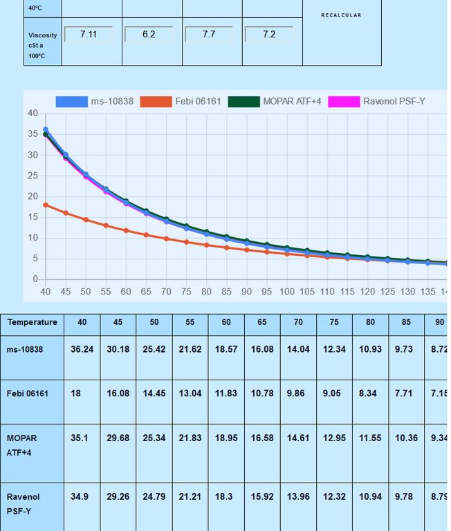

    • Позаровичках се малко и с маслата за хидравликата и кутията, и излязоха някои интересни неща:
      Type Color Viscosity @ 40c Viscosity @ 100C Viscosity index
      MOPAR MS 10838 None 36,24 7,11 163 MS-10838
      MOPAR MS 11655 (68088485AA/B) Green 18,9 MS-11655, MS-90030
      Febi 06161 / SWAG Green 18 6,2 345 MS-10838, MS-11655B, CHF-11S
      Yacco DA Green 19,7 6,6 335 MS-11655, MB 345.0, CHF-11S
      Ravenol SSF Green 19,7 6,6 333 MB 345.0, CHF-11S
      Motul Muti HF Green 19 6,2 328 MS-10838, MS-11655, MB 345.0, CHF-11S
      Pentosin CHF-11S Green 18,7 6 313 MS-11655B, MB 345.0, CHF-11S
      Valvoline SynPower Green 18,7 6 313 MB 345.0
      Tutela GI/R Green 18,7 6 313 MS-90030-P2, MB 345.0
      VAICO VA-002-SYNT Green 19 6 315 MS-9602, MS-10838, MB 345.0, CHF-11S
      ADDINIOL AHF 22 S Green 23 6 225 MS-9602, MS-10838, MS-11655, MB236.3, MB 345.0, CHF-11S
      Westway Synthetic PSF None 36,1 7,4 206 MS-9602, MS-10838, MB 236.3
      Divinol Zentralhydraulikfluid S Green 27 6,5 190 MS-9602, MS-10838, MB 236.3, MB 345.0, CHF-11S
      Ravenol PSF-Y None 34,9 7,2 177 MS-10838, MB 236.3
      LubeGard None 36,3 6,6 140 MS-10838, MB 345.0, CHF-11S
      Yacco ATF X Red 37,5 7,8 183 MS-9602, MS-10838, 236.1-11
      MOPAR ATF+4 Red 35,1 7,7 198 MS-9602
      Castrol Transmax ATF+4 Red 33,2 7,5 204 MS-9602
      Havoline ATF+4 Red 33,2 7,5 204 MS-9602
      Mobil ATF+4 Red 34,4 7,5 200 MS-9602
      Pennzoil Platinum ATF+4 Red 35,1 7,7 198 MS-9602
      Valvoline ATF+4 Red 34 7,5 198 MS-9602
      Ravenol ATF+4 Red 35,1 7,5 192 MS-9602
      Tutela Transmission Force 4 Red 36 7,6 188 MS-9602, ATF+4, MS-90030-A4
      Motul Multi ATF Red 36,2 7,6 185 MS-9602, MB 236.3-12
      Addinol ATF XN 5 Red 35 7,2 182 MS-9602, MB 236.1-14
      AMSOIL OE OTF Red 36,5 7,5 180 Chrysler ATF+4 (-38C min), MB 236.1-11
      Havoline Multi Vehicle ATF Red 37 7,3 169 Chrysler ATF+4, MB 236.9
      AMSOIL Signature Multi Vehicle ATF Red 38,5 7,5 165 Chrysler ATF+4, МB 236.1-11
      Bardahl ATF+4 Brown 36,6 7,2 165 MS-9602, MB 236.1-10
      FEBI 29934 Red 37,3 7,3 165 Chrysler ATF+4, MS-9602
      Вижда се че всичко, съдържащо "ATF+4" в заглавието си, е доста близо като вискозитет при 100 градуса.
      По-интересното е обаче при маслата за хидравлика (първата половина на таблицата):
      - Има такива, отговарящи само на 10838, има такива отговарящи и на 11655 (което е за новите WK-та след 2010), има и такива, отговарящи както на тия двата, така и на 9602 (което е стандарта на Chrysler за ATF+4).
      - Няколко, включително Ravenol-а, който ползвам в момента, като вискозитет е по-скоро ATF, отколкото PSF.
      - Повечето, отговарящи на 10838 и/или на 11655, отговарят и на MB 345.0.
      - Pentosin CHF-11S и Valvoline SynPower са с толкова еднакви характеристики че най-вероятно са едно и също масло, но "сертификатите" им са различни.
      - Вискозитетния индекс също разделя продаваните за PSF масла на горе-долу 2 групи, такива с около и над 300, и с вискозитет при 100 градуса като на PSF, и такива с около и под 200, с вискозитет по-скоро като на ATF
      - Всичко, що се продава като PSF, е или неоцветено (и по-гъсто и с по-малък вискозитетен индекс, по-приличащо на MS-1083, или бледо зелено (и по-рядко и с по-висок вискозитетен индекс, по-приличащо на MS-11655) на цвят. Всичко, дето се продава за ATF+4 е червено.
      На база всичкото това има мегдан за спекулации че PSF-а трябва да е с вискозитет малко над 6, и най-вече това е главната разделителна линия между ATF и PSF при Jeep WK/XK. Има и мегдан за спекулации че всичко, що отговаря на 11655 и/или MB345.0, отговаря и на 10838, което доста разширява кръга на маслата, които може да се ползват. Отделно MS 11655 е драстично по-евтино и в оригинал ot 80те лева за литър 10838.
      Понеже ще връщам Deckelmann помпата на RockAuto и ще ми пратят друга, следващото ми наливане в хидравликата ще е или Febi 06161, или Motul Multi HF, пък да видим какво ще се случи. Не че сега не е ОК де, но предвид вискозитета на Ravenol-а, който ползвам в момента, и факта че на студено определено помпата се чува повече (не много, но повече), може правилното масло да укроти нещата още повече.
      ПП: Допълних и с MOPAR-ски масла, и с някои други. Просто трябва да се търси по парт номер, не по спецификация.
      ППП: Другото, дето прави впечатление е че оригиналното ATF+4, ако съдим по вискозитетния индекс, излиза висок клас синтетично масло, докато с MS-10838 хич не е така - скромен индекс 163, на фона на 345 за Febi 06161, което е по 20 кинта литъра, на фона на 80те за оригиналното.
      Последно редактирано от sparkybg; 02-04-23, 18:14.
      • ADDINOL ATF XN 5 - Viscosity @ 40c - 35, Viscosity @ 100C - 7.2, Viscosity index - 182, MS-9602, MB 236.1, MB DTFR 13C120 (236.2), MB 236.3, MB 236.6, MB 236.7, MB 236.10, MB 236.5, MB 236.12, MB 236.14, MB 236.15, MB 236.91
        Защо не подредиш маслата по двойки еднаквите?
        Jeep Cherokee KJ, 2.8crd LIMITED Auto, 2004г. & TABBERT Jeunesse 560
        Око за око, паста за зъби!
        Когато вярата срещне надеждата, животът намира начин!
        • Горната група са масла за хидравлика, долната са ATF. Вътре в групите са подредени по вискозитетен индекс, с изключение на оригиналните. Вискозитетния индекс горе-долу показва колко висок клас е маслото поне по тоя показател. Няма пряка връзка с добавките и тестовете за износване, защото такава еднотипна информация не е налична за почти нищо. Например AMSOIL Signature Multi Vehicle ATF е висок клас масло заради добавките, нищо че като вискозитетен индекс не е върха на сладоледа.
          Ще добавя и постнатоито от теб, но няма как всичко - сигурно има поне по още 20-ина във всяка група. Целта е просто сравнение, доколкото е възможно.
          Последно редактирано от sparkybg; 02-04-23, 18:18.
          • Разтърсих се и освен един лист за безопасност(вискозитетът е същият,като в таблицата по-горе),нищо другo не открих .
            Навсякъде се оплакват,че:
            -няма го никъде,а де го има(стари наличности само), искат един бъбрек.
            -крайслер не дава никаква информация защо го няма и защо,когато доскоро твърдо са държали на него в някои приложения,са се отметнали и сега всички дилъри ( и Мопар като търговец) предлагат само +4 като замяна.
            -също тъй се били изхитрили за пари да пуснал нарочно Power Steering +4 (а вътре си е ATF +4 с друг етикет)...не знам дали е вярно.
            Ей тука една от многото теми (обърнете внимание на мнение #36) .
            https://www.jeepforum.com/threads/po...1754010/page-2
            Чудно какво толкова е било необичайното в спецификацията MS-10838...нищо не се намира. Дали заради перката или нещо друго има по-особени фрикционни характеристики...дали на системата й трябва по-висок вискозитет при работни условия (долу е темп.-виск. плот при темп. от 40 нагоре...на Феби ,разбира се, е доста по-различен).Някой мерил ли е тук-там колко температура дига (в казанчето,покрай помпата и маркучи след дълго юркане)?
Прегледи:840
            https://i.imgur.com/ktPHZiu.png
            Аз,ако трябва да избирам,бих бил раздвоен м/у PSF със сходни х-ки (като Ravenol PSF-Y или LubeGuard) или това,което прави Крайслер от известно време (промивка и после ATF/PSF +4. ОБАЧЕ +4-ката да е от актуалния лист с одобрените продукти,а не пенкилер "meets or exceeds the requirements of ATF +4")
            Списък на официално одобрените продукти :
            https://www.centerforqa.com/licensed-atf4-brands/
            Ей на : " Replaces: 5013457AA, 5142893AA, 68218057AA, 68218057AB, 68234631AA, 68234631AB"
            https://store.mopar.com/oem-parts/mo...uid-68218057ac
            ...ама за причините,ама процедурите по замяна...мълчание.
            Последно редактирано от sparkybg; 03-04-23, 10:54.
            • sparkybg
              sparkybg коментира
              Добавих картинката да е във форума, да не се затруе по някое време.
          • Не съм засичап поне течността в казанчето да е много над 60 градуса, доколкото може да си задържа пръста поне секунда-две. Върху радиатора включително. Подозирам че лятото в жегите с климатик и по-усилено участие на перката в охлаждането ще мръдне до към 80 поне. Фактът че има нарочен охладител за хидравличното масло, при това съизмерим като площ с тоя на скоростите, говори че все пак има режими, в които се спича доста.
            Някой из форума беше предположил че просто е свършила партидата на някой дефектен чарк, чиито уплътнения или нещо друго не се харесват с нещо в ATF+4 маслото. Моята джипка е 2009-та година и си дойде с безцветното масло. Тоест поне до 2009-та не е имало замяна с ATF+4, и доколкото 2010-та е последната от тая серия, според мен каквото е ставало е станало след това.
            В момента маслото се намира и в америка и тук. Доколко наистина е оригинално или поне отговаря на характеристиките на оригиналното, не знам.
            Интересното в таблицата е че въпреки че е очевидно че 10838 като вискозитет в оригинал си е почти като ATF и се отличава с това че е безцветно, и въпреки че 11655 очевидно е по-рядко и зелено оцветено, има доволно количество масла, които покриват и двете спецификации, а някои дори и ATF+4. Тоест каквито и да са конкретните изисквания на MS 10838, те явно касаят нещо друго, а не вискозитета. Или поне вискозитета в тоя стандарт е в доста широки граници.
            Например за ATF+4 едно от нещата, претенциозни за покриване, е вискозитет при -40C. И например едното от маслата на AMSOIL не го покрива при тая температура, а пише че трябва да се ползва при над -38C.
            Аз все пак ще пробвам с Febi. От зелен I.G.A.T за около месец нищо не му стана, въпрекли че после се оказа че покрива само 11655, не и 10838. Не друго - помпата се чува осезаемо повече на студено, и ми се ще да видя какво ще се случи с оригинална помпа + зелено масло. Неоригиналната си виеше порядъчно с всяко от двете без особена разлика.
