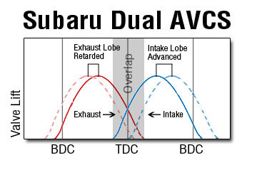

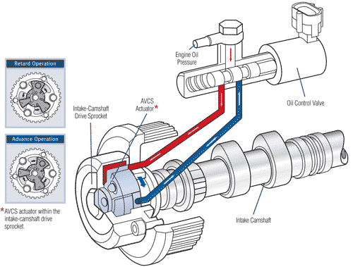

            Страна работа... в съседната тема се казва, че 3.6 е по-ненаджден от 3.0, пък американците разправят точно обратното. Спрямо 3.0 са намалени горещите точни с подобряване на маслените и водните пътища, цилиндровите ризи са удебелени и степента на сгъстяване е намалена. Отделно вече е с променливо газорапределение.
            "Lower octane fuel simply ignites easier so under load if an engine develops hot spots that easier to ignite fuel ie less stable fuel pre ignites and causes bad things. Premium fuel or more stable fuel simply reduces the chances of lighting off at the wrong time. Your right the 3.0 hot spotting was due to cooling pathways and oiling paths that werent really set up well. The 3.6 is well done and had to be given the flack Subaru caught for the 3.0 issues."
            "EZ36D uses the strengthened cylinder block, inside of which there are cast-iron sleeves 1.5 mm thick. Diameter of cylinders was increased to 92 mm, the crankshaft with a piston stroke of 91 mm was installed in the block. Cylinder block deck height didn’t change and it is 202 mm. EZ36 applies the new unusual asymmetric connecting rods, their length is 125 mm, and the compression ratio was lowered to 10.5. All these modifications allowed to receive 3.6 liter capacity."
            http://www.comeanddriveit.com/engine...avcs-explained
            https://www.iwireservices.com/single...-2002-2005-WRX
