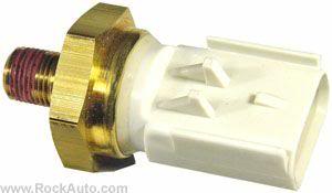

          Пишат, че трябва да се смени датчика за маслото - Sending Unit Oil Pressure. Преди е бил Part.№ #56044777AA, а сега го дават Part.№ #05149062AA is the NEW updated part, макар и да намерих обратното твърдение. Ето и още по темата със схеми на ел. връзки.
Име:Oil Sending Unit 3Pin Connector.jpg
          Looks like you need to replace the oil pressure sending unit. Mopar OE 5.7L oil pressure sending unit part number: 56044777AA. The pressure sensor has a 3 wire connector and sits on the front of the motor behind the alternator.
          Here's a write up on it. How to change the oil pressure sensor - LX Forums | Dodge Charger Challenger Magnum | SRT8 | Chrysler 300 Forum
          FYI- There is another sensor (oil temp sensor) close by that has a 2 wire connector.

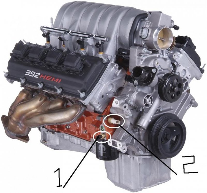

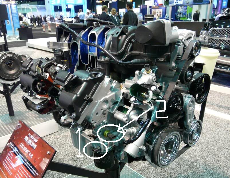

          Here is the 6.4 block.....Sensors are same on the 5.7 & 6.1
          Below, #1 is the oil temp sensor (2 wire connector)

          Below, #2 is the oil pressure sensor (3 wire connector)

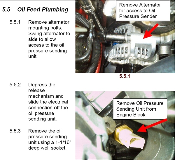

          Ето и още за смяната му:
Име:sending unit.jpg
          Дано да ти е от полза!
